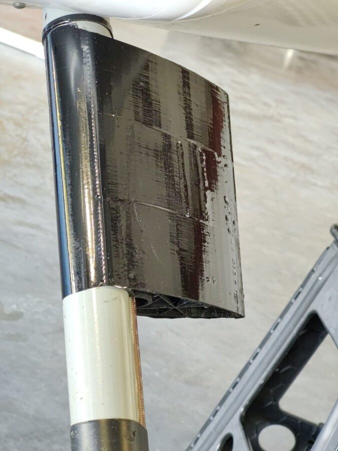

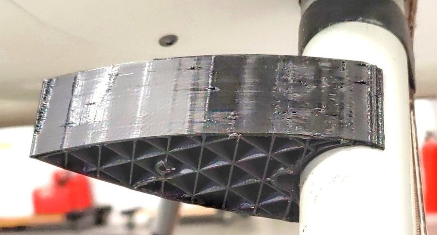

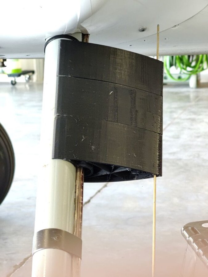

I started with this little project for the fun of it. I’m doing this on my Glasair Sportsman but thought I would also try this on the sonex as well. So I thought I’d share a few pictures in case anyone is interested.
First I drew the entire full length fairing but printed in short segments so they don’ crack with gear flex
The segments snap onto the gear leg and get aligned with a hing pin. Final assembly would involve something like RTV to help secure.
Fianally they are covered with vinyl wrap. This is just a short test length.
Still to do is to refine the 3D print process to get the exterior nice and smooth. Also remove most of the excessive interior support.
