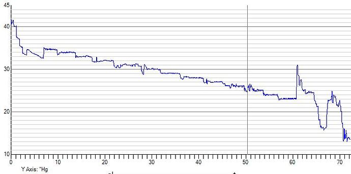

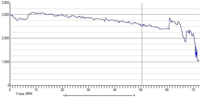

Did some testing of the redcube and found…
Ground…
While on the ground in a level attitude, my redcube is accurate (weighed the fuel) from 40 gph free flow (carb disconnected) to 10 gph. Below 10 gph the cube begins to read low. At 3 gph the cube is 25% low. The flow points in between 10 & 3 lie on a straight line. Given this, adjusting the k factor will never fix the flow readings. If I adjust to fix the low end, the high end will be off. I I adjust to fix the mid range, high and low will be off.
Flight…

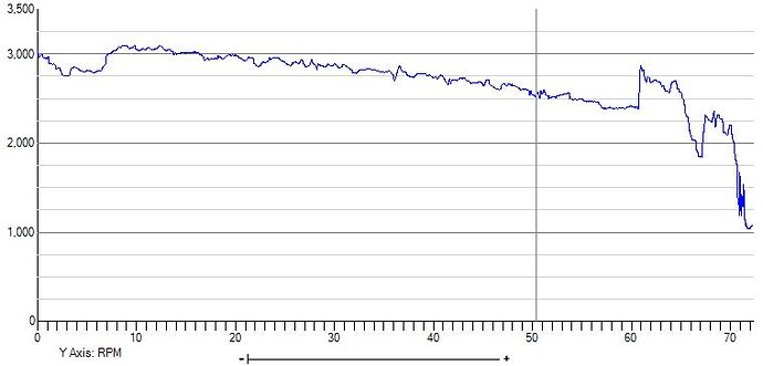

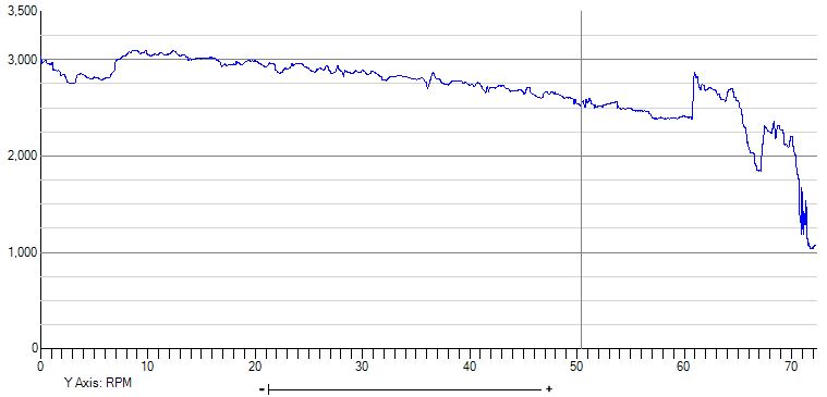

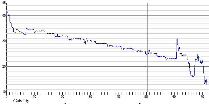

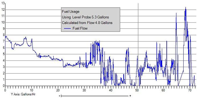

In flight, the cube is useless below 4-5 gph. I also found that a flow reading at a certain MP & RPM may be one value now and something completely different later, ie Ive seen both 6 gpm % 8 gpm at 35".
Below are graphs from my last flight, as seen in the Flight Data Viewer. The first is flow, the second is MP and the third is RPM. In this flight test I gradually reduce MP from 35 down to 25 or so to record flow (between 7 & 62ish on the X axis). Note the FF below 5 gph. My fuel system is per the B plans. My cube is between the tank and shutoff valve. No gascolator. Engine is running really good.
At this point I’m not sure what the issue is. Any thoughts, suggestions?
Re: Aerovee Turbo Fuel Flow
Posted: Sat Jan 13, 2024 10:29 am
by pappas
Peter,
I haven’t seen anything like that before. Every red cube I have owned worked accurately. The obvious things are something amiss in the electrical connections, usually a loose ground or data lead, but the cube connections are simple and I doubt that you would have missed that. The other thing is that you could have a bad cube. My go-to is always that I messed something up but I have had brand-new electrical components that turned out to be bad after a lot of troubleshooting my own work.
The installation instructions say to have the fuel flow enter and exit the cube in a level attitude and that a downward drop at the exit could cause faulty readings as an air bubble could rise back to the turbine wheel. That is exactly how we set these up in the Sonex. I did as well but did not experience the faulty readings. But, if they make that reference, they likely have seen those results in their testing.
At this point, I would contact the manufacturer, give them your data, and ask them what they think. Sorry, you’re having issues.
