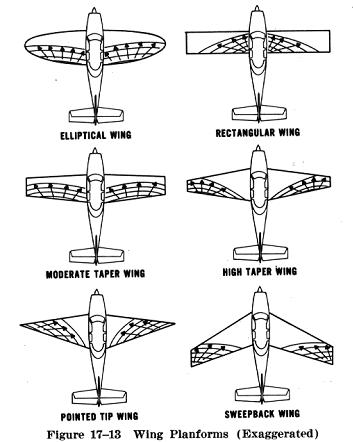

interesting vid has it got washout in the wing cos it looks as though it has --or a different section at root to tip ?
Re: buying a sonex
Posted: Mon Jul 05, 2021 5:10 pm
philb wrote:interesting vid has it got washout in the wing cos it looks as though it has --or a different section at root to tip ?
No -normal stall progression for a Hershey Bar wing. I learned something too from those tests, this forum and then doing some research.
