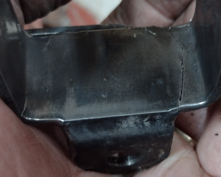

We were flying patterns today and started getting a noise from the tailwheel. Knocked it off and discovered this crack. The tailwheel bracket was noticably bent.
cracked tw bracket on airplane.png (624.37 KiB) Viewed 1738 times

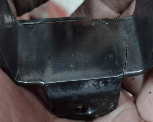

Powdercoat stripped off:
cracks after powder coat removal.png (467.91 KiB) Viewed 1738 times

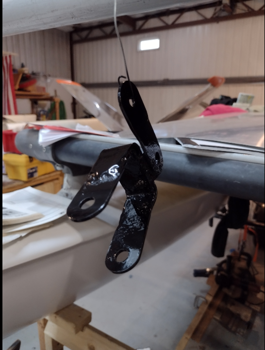

I welded it back up, and welded on some doublers as well.
painted reinforced bracket.png (470.1 KiB) Viewed 1738 times
Edit: the smaller cracks were hidden by the powdercoat. The noise was the pivot bolt head dragging on the ground. The noise started off just when we hit a bump, then got more steady.
