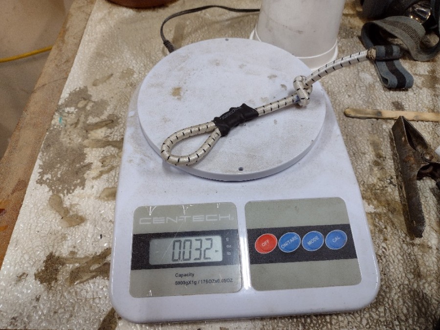

I have center (sport trainer) controls built to plans. The flap stop angle is built to let you pull smoothly from the first notch to full flap - but on the ground you can’t select the first notch. Gravity pulls the flaps to full. For takeoffs, we had been using a leg to hold it in place during the takeoff roll. Works, but not the best. Also not possible when soloing from the right seat. So, I made a bungee to counteract the weight.
As you can see, it weighs nothing. I didn’t weigh the hole I drilled in the flap stop.
The bungee is threaded through the hole and knotted. The loop around the flap handle is held by a couple of hog rings and covered with heat shrink.
