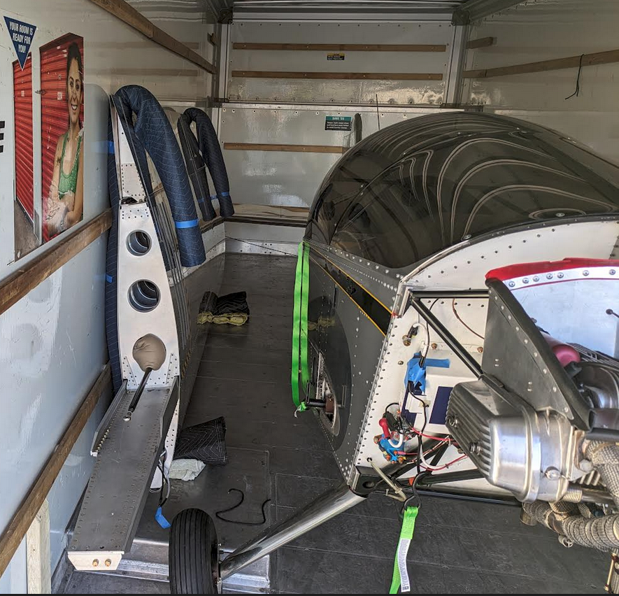

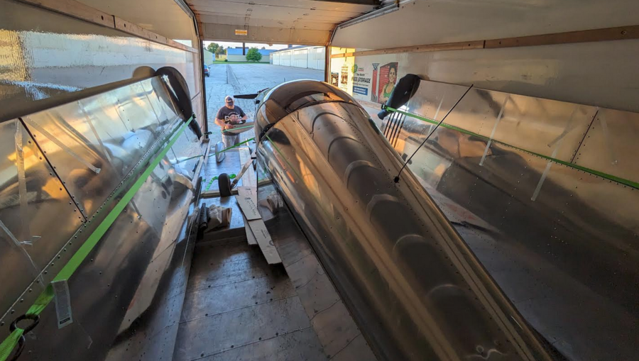

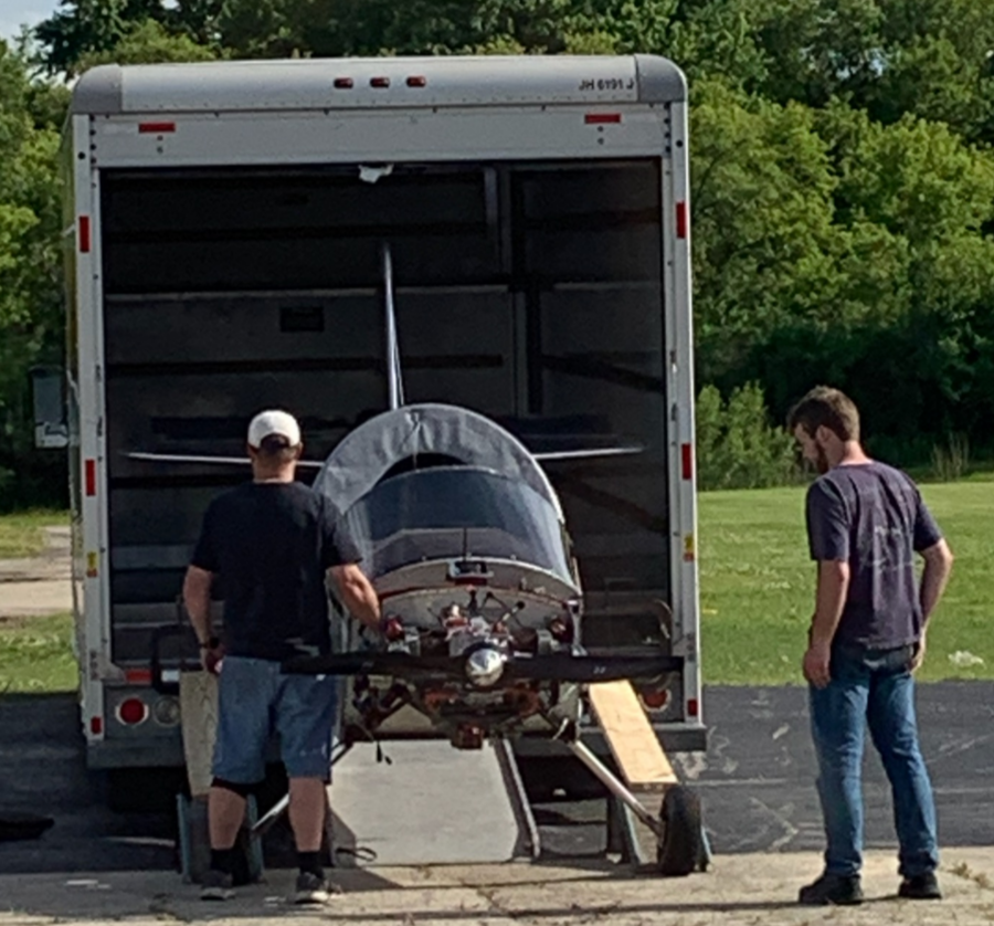

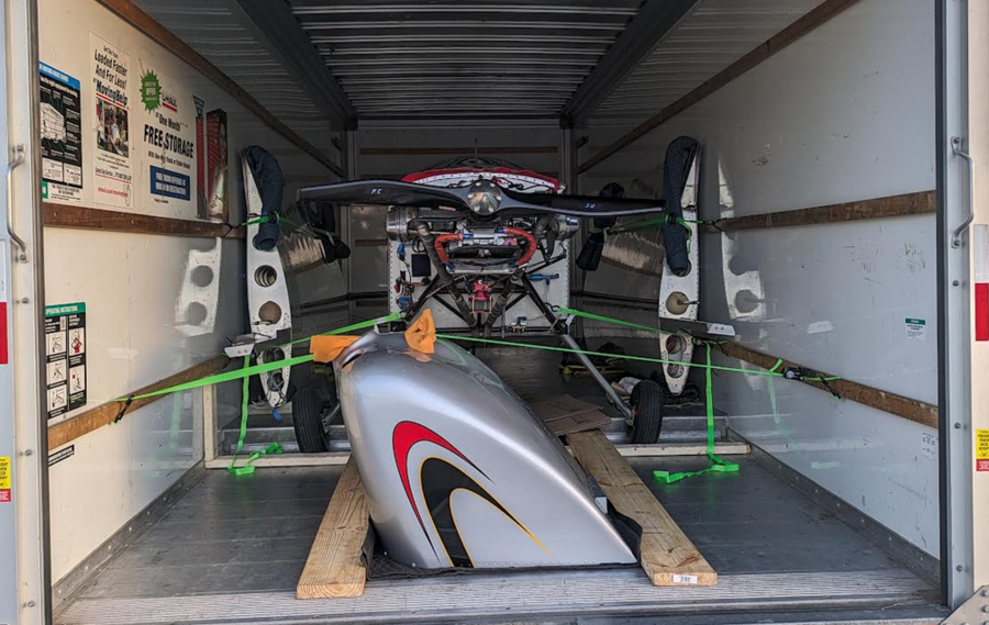

I sent Ryan a bunch of pictures. We had the cowl off and ratchet strapped to the motor mount. Tied/strapped the tailwheel. Rolled up a couple moving blankets into tubes, tied them to the wall, and ratchet strapped the wing to them. That was hambone’s idea and worked well. Had some blankets on the wheelwell and another stack deeper in the truck for the leading edge to rest on.

I think two longitudinal straps/wing might be a tad safer.
Cardboard or plastic right angle edge savers, where strap goes over an edge will help preserve edge & strap.
