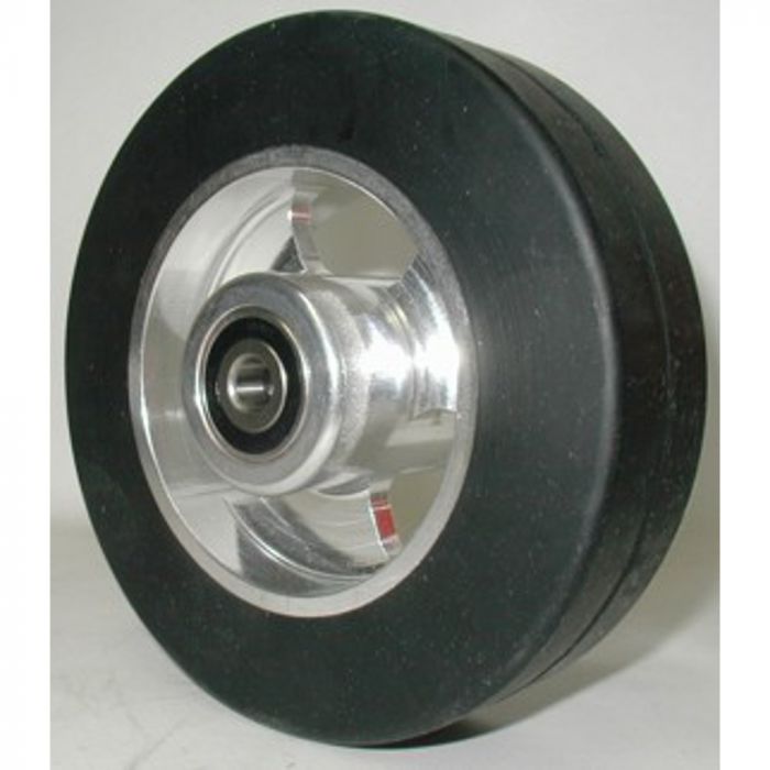

Great Plains used to sell a very nice 5" tailwheel. I had a new one on my plane and bought a used one second hand from the seller’s table at one of the last American Sonex Association Fly-ins back in the day.
If I had to replace a tailwheel now I’d buy one from Van’s as they are excellent quality:
https://store.vansaircraft.com/6-rubber … -lw-6.html
I learned some time ago that for the important stuff … “buy the best and cry once!”

These are the bearings I bought:
https://www.amazon.com/gp/aw/d/B08YRDVJQZ
Seemed to have good reviews from the gocart people. They definitely spin a lot better than the stock flanged bearings. For some reason my Aircraft Spruce hardware kit came with two tailwheels. On the unused tailwheel I was able to use my hands to press the new bearings in. On the tailwheel that I’ve been using, I had to use an arbor press. It was a light press fit.
The ID of the new bearings is 5/8" and the axle bolt is 3/8". Adam made an aluminum bushing on the lathe although you could probably buy one. I made a couple of skinny (in the radial direction) aluminum washers that clamp between the fork and the inner race. They center the wheel.
Weight savings is about 0.05 lbs. Helps counter the 0.1 lb weight gain from my fork reinforcement.
