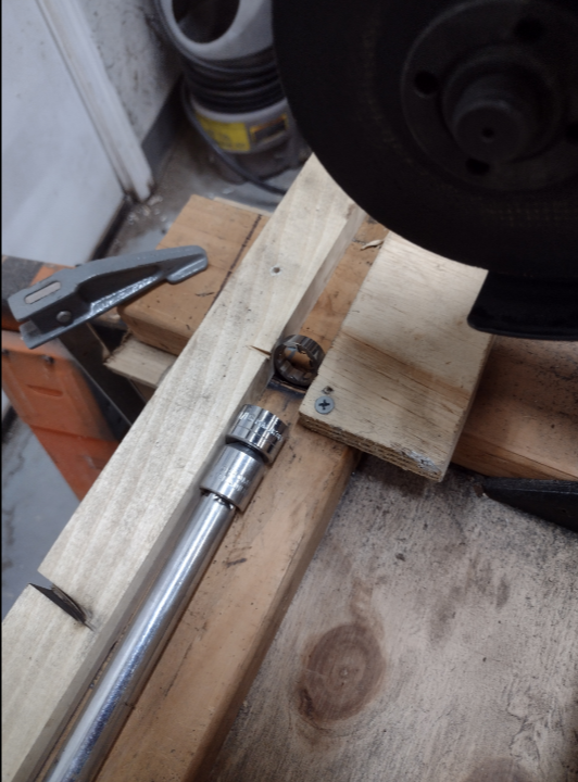

… hard to do. My baffles are all sealed to the motor with RTV, so it’s a pain to remove and replace them. So I cut up a cheapie 11/16" socket using my 3D printed chop saw attachment:
socket chopping.png (547.95 KiB) Viewed 1049 times

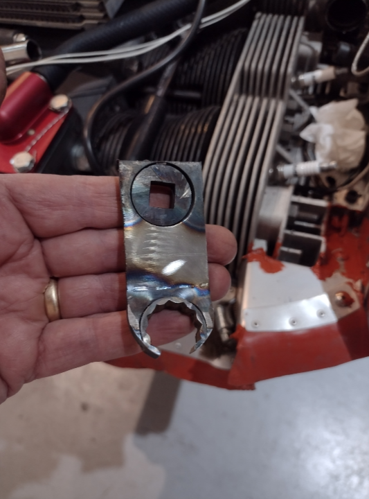

Then I holesawed a piece of steel, 2" hole spacing. Welded in the socket parts.
spark plug offset tool.png (458.61 KiB) Viewed 1049 times

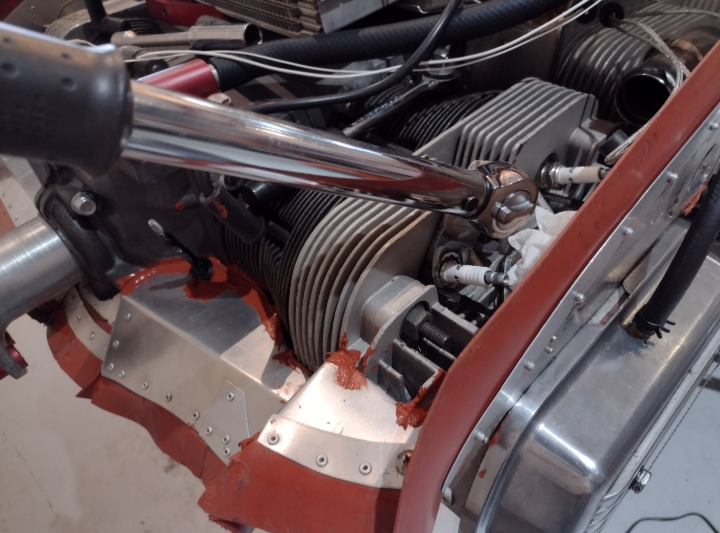

New plugs getting torqued up:
plug torque wrench extension in use.png (591.22 KiB) Viewed 1049 times
